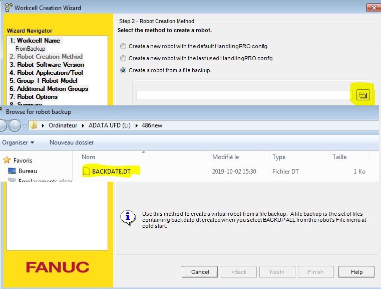

Losev, see the Tutoriel "Backup on USB key" and after, create a new Robotic Cell with Fanuc Roboguide Software and select "Create a robot from a file backup."
https://forum.diy-robotics.com/hc/en-us/articles/360035636932-Backup-on-USB-key
