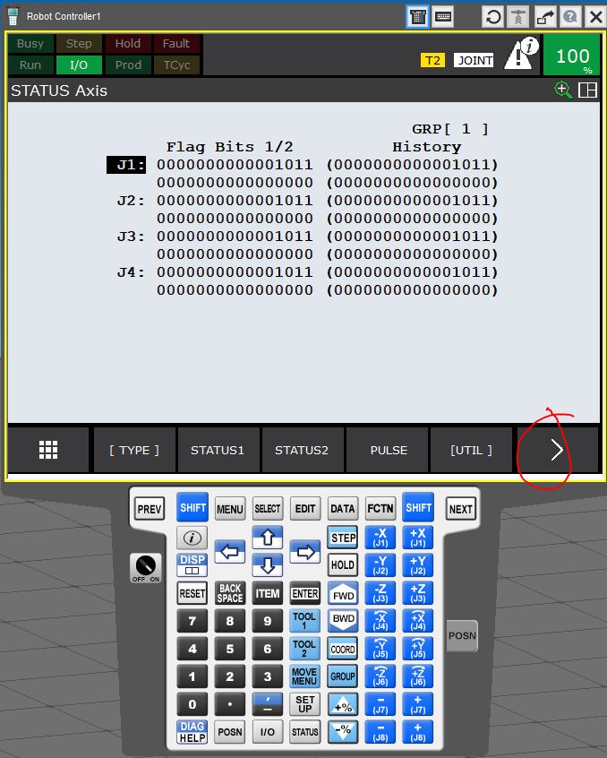

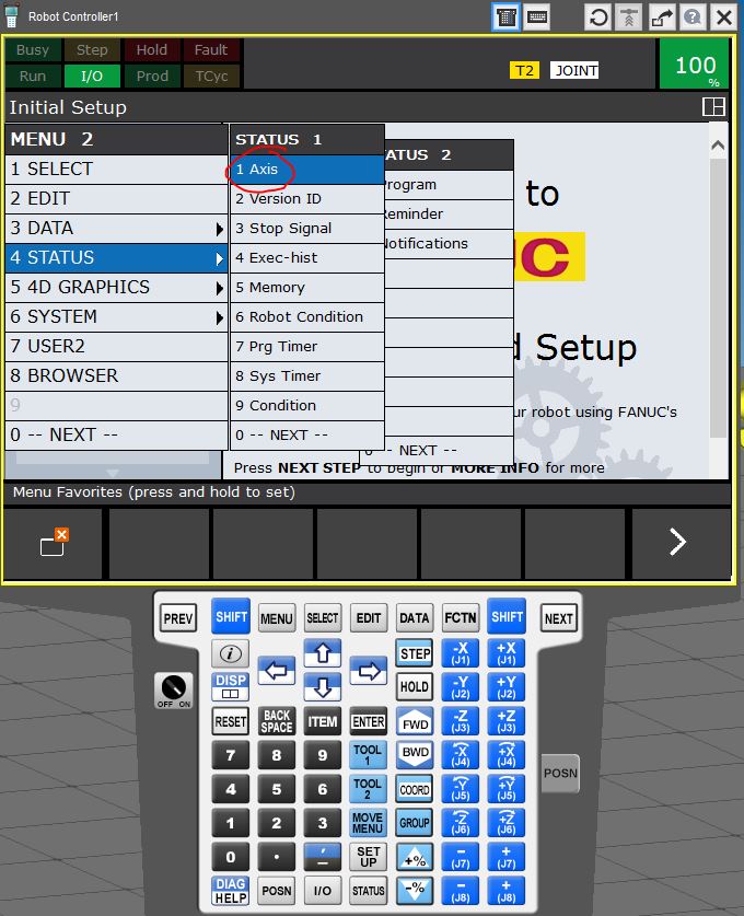

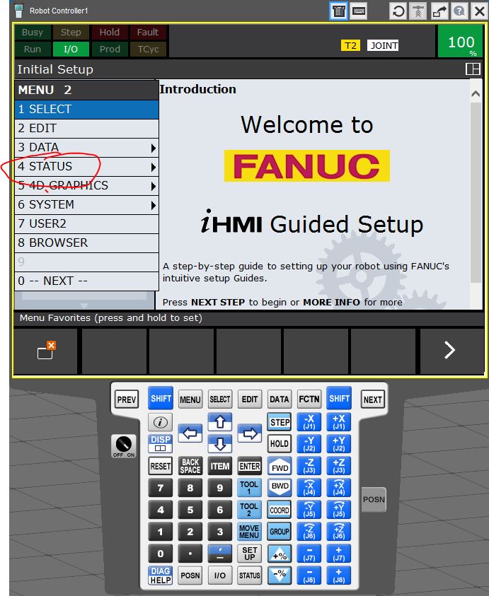

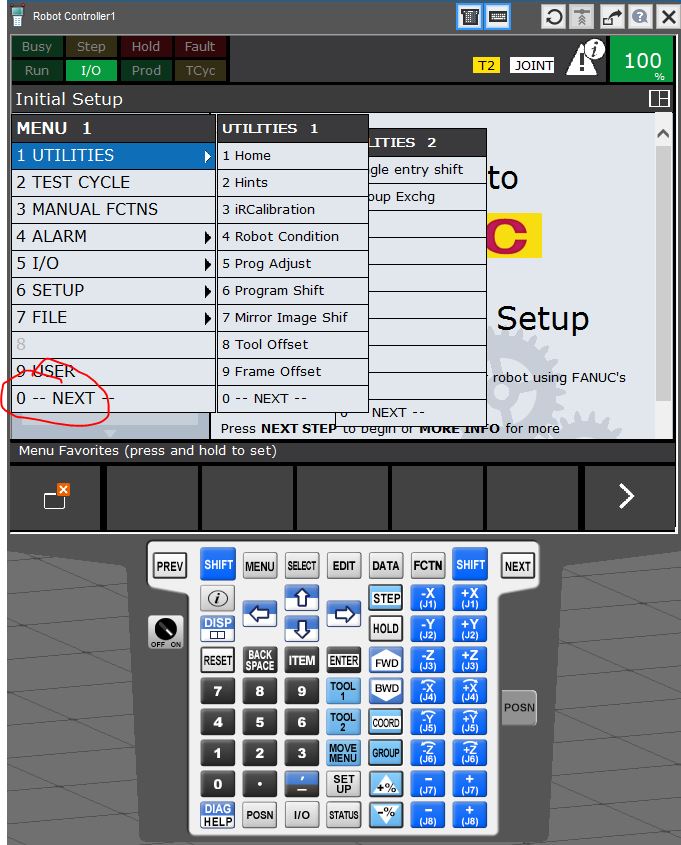

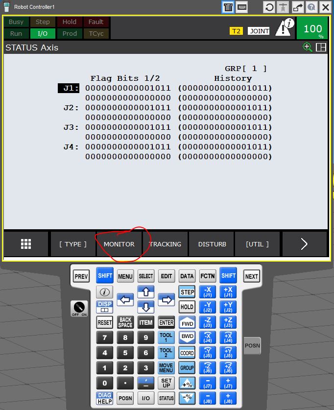

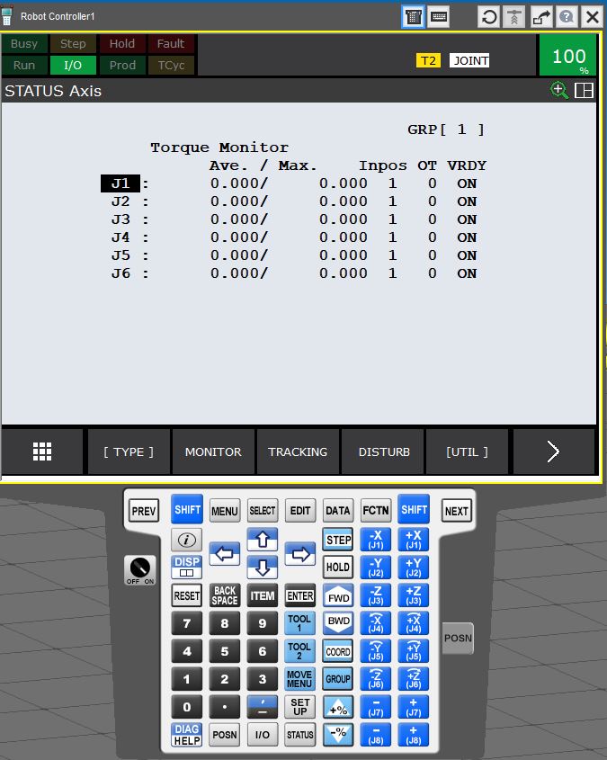

You can monitor torque values by following method.
1>
2>
3>
4>
5>
6>
7>
