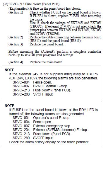

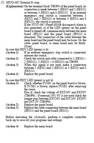

I am facing a problem on RJ3iB Controller it is displaying below mentioned alarms:
SRVO-007 External ESTOP
SRVO-213 Fuse Blown (panel board)
While everything seems to be okay, the fuse in working fine, the green light (Ready) is also on I have tried jumpering the ESTOP circuit also but all of this did not help to clear any alarm.
I am sure you guys can help me here. Please help me clear these alarms.
