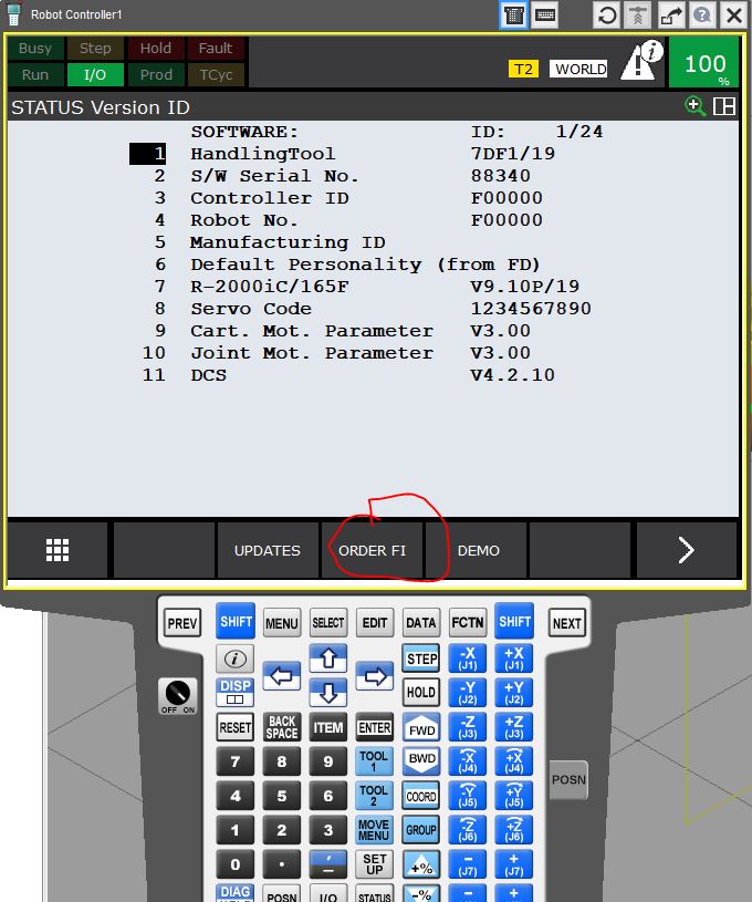

Hi All ,
How to check if i have TAST PAC installed on my robot or not ?

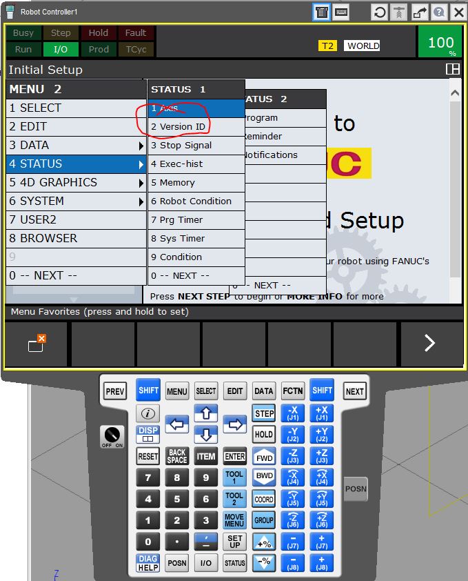

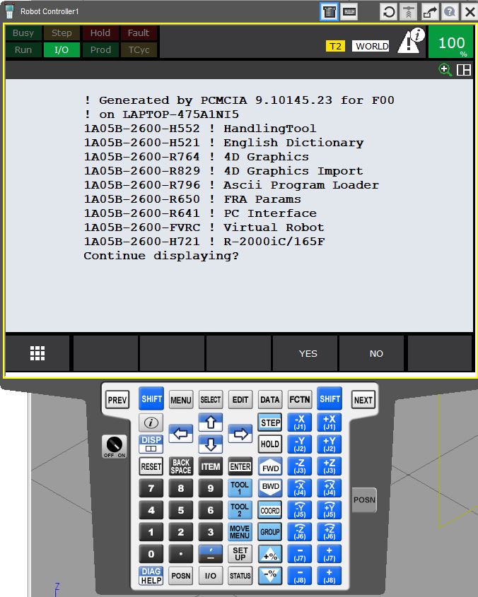

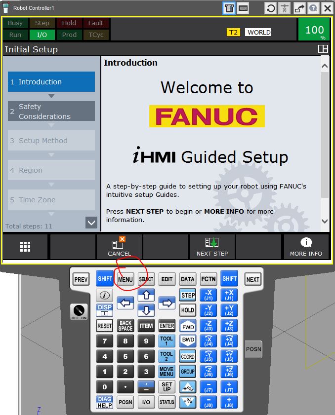

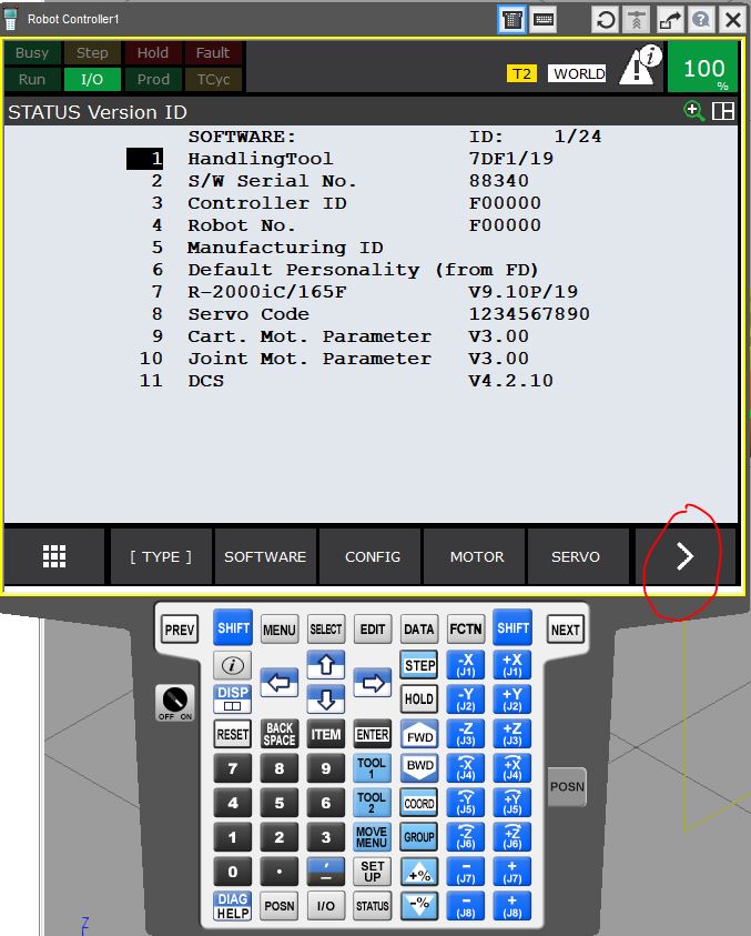

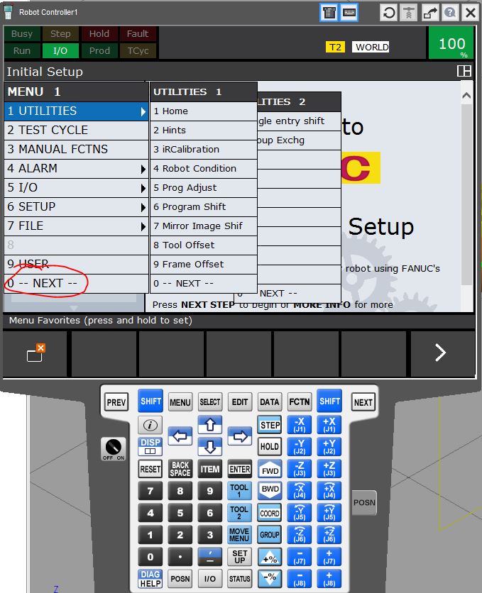

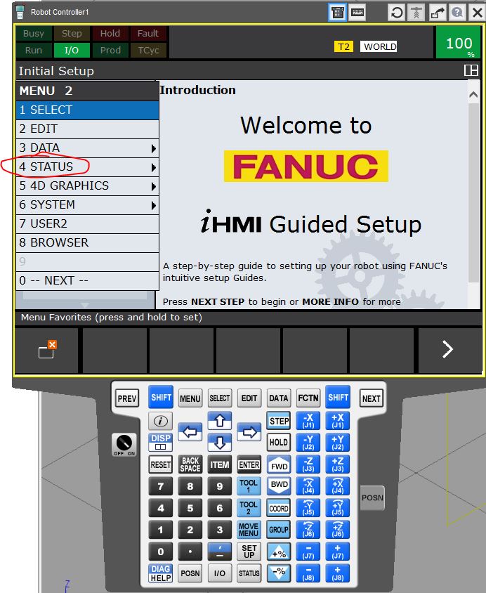

Kindly follow below steps
1>>
2>>
3>>
4>>
5>>
6>>
7>>
Thank you so much. So i can know now that if the PAC is already installed or not ..!
