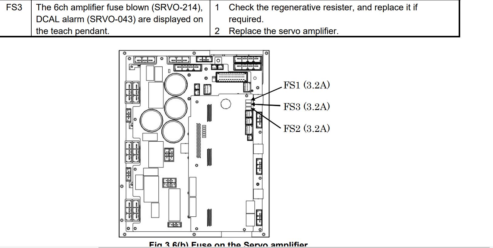

I have R30iB controller , I connected a component and for power supply it was taken from  EE connector yesterday as we restarted the robot I am receiving this ALARM.
It says , SRVO-214 6ch amplifier fuse is blown. Where to check this fuse ? And what precaution i should be taking for not blowing it up again ?
