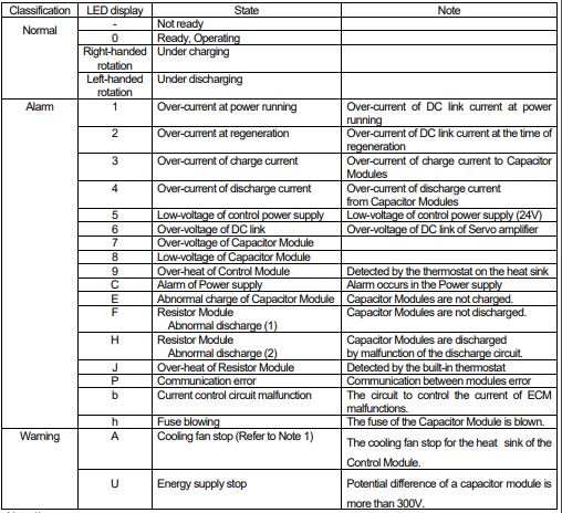

I have servo amplifier A06B-6140-H055. There is fault showing on ECM module. The LED display no. 4. Can anyone help me with this alarm?
What does it indicate?

New postI believe it is the Manual No. B- 65282. I have a copy of it . Take a look at alarm led status.
