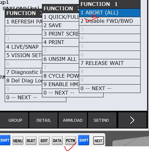

I am stuck at the error. I am trying to edit the program but it says , its in use. How to go ahead and how can i edit the program ?
New postThere may be any background program running. Stop all the program and try.
Use FCTN --- > ABORT (ALL)
