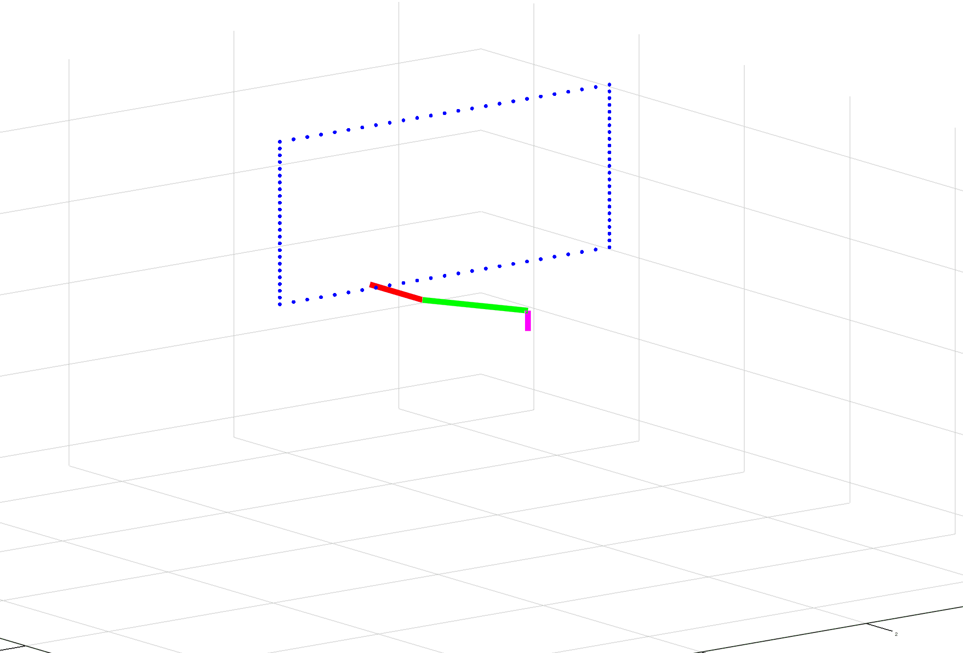

Now some background: I am working on a hexapod and trying to design the inverse kinematics and path following for the individual legs. Because this will involve a lot of repletion/trial and error, I am designing a simulator to help me test my pathing so I don’t accidentally break something. I’ve laid the groundwork for a lot of it; drawing the robot, homogenous transform calculation, even calculating the Jacobian.
What I’m running into is trouble solving for the inverse Jacobian. The first time it’s calculated seems fine and the arm moves a little bit toward its target. The second time it’s calculated, the values go to extremes causing the arm to basically invert itself. The third and subsequent times, it seems fine. (See gif for example.)
I’ve reviewed formulas, not seeing any issue there. I’ve reviewed outputs and haven’t found anything out of the ordinary besides the pseudo inverse. And the visuals appear to make sense after the inversion of the arm.
