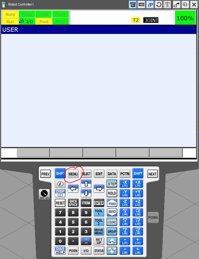

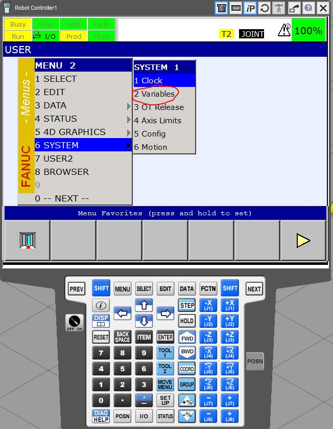

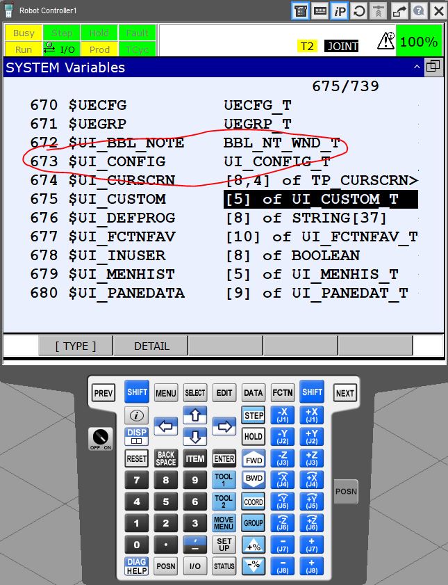

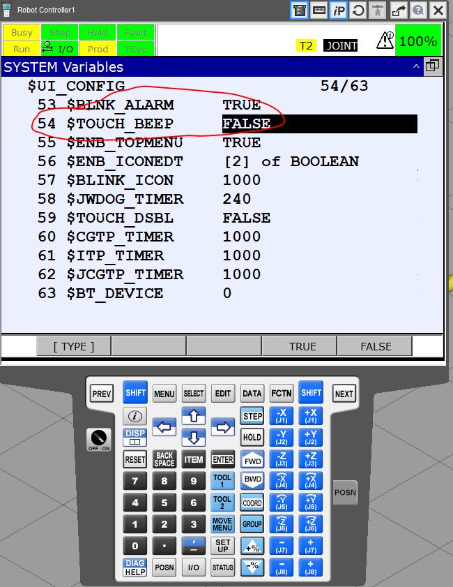

You can go to system variable and unable it followed by restart.
$UI_CONFIG.$TOUCH_BEEP
1>
2>
3>
4>
5>
6>
