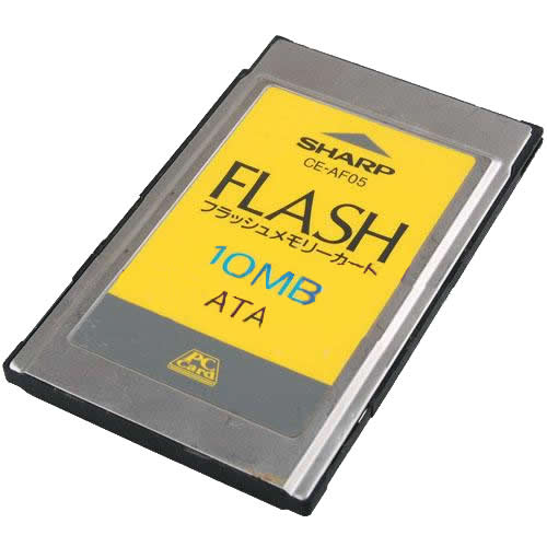

I am using following card. Please help

it's possible that one or more of the internal pins are bent.
Flash card are not supported. Only SRAM Cards are supported
