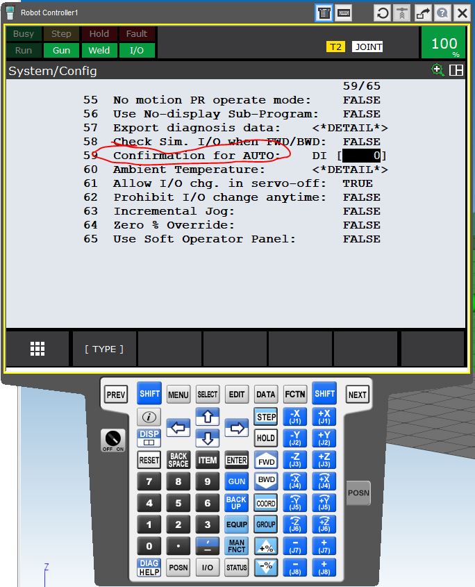

New postThis option is part of production setup

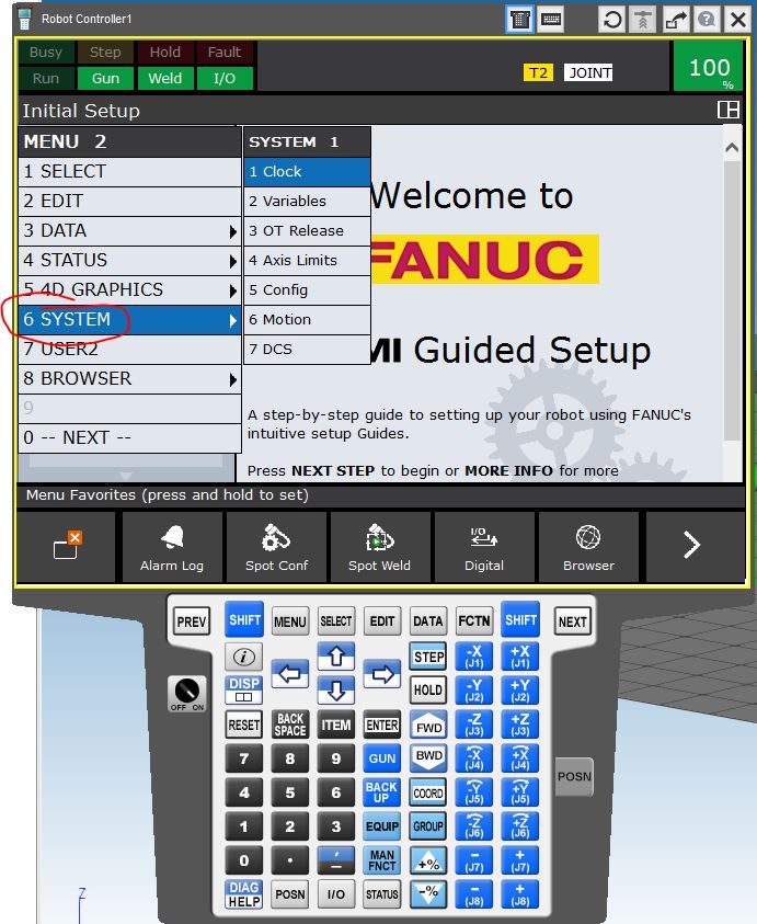

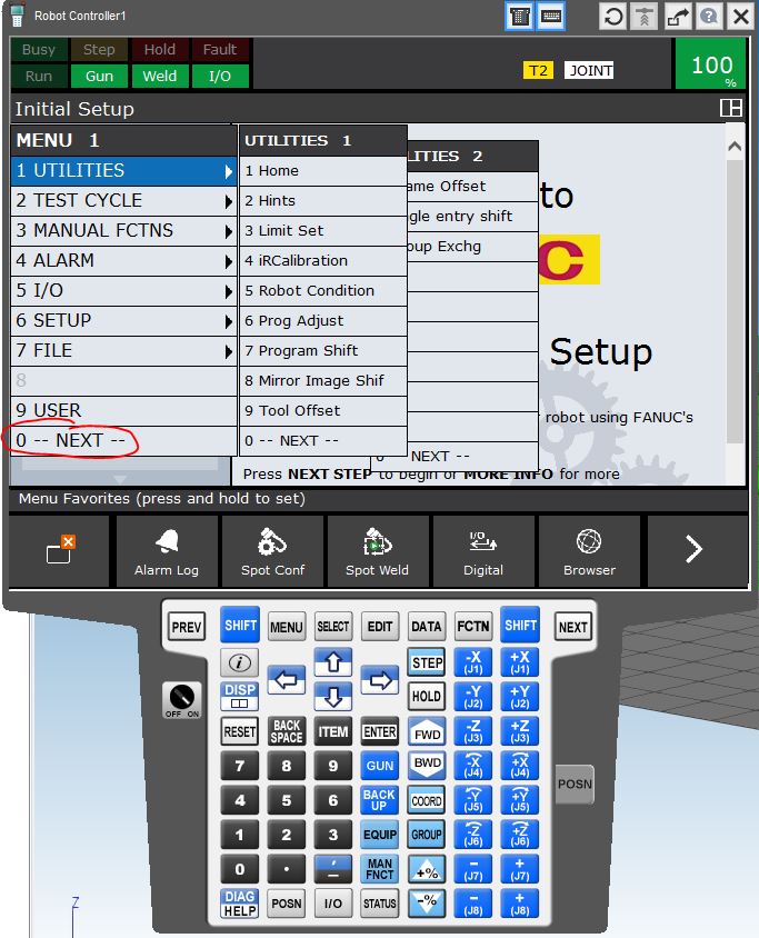

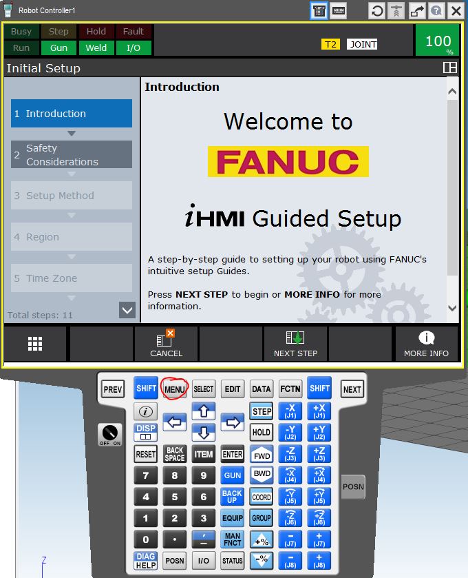

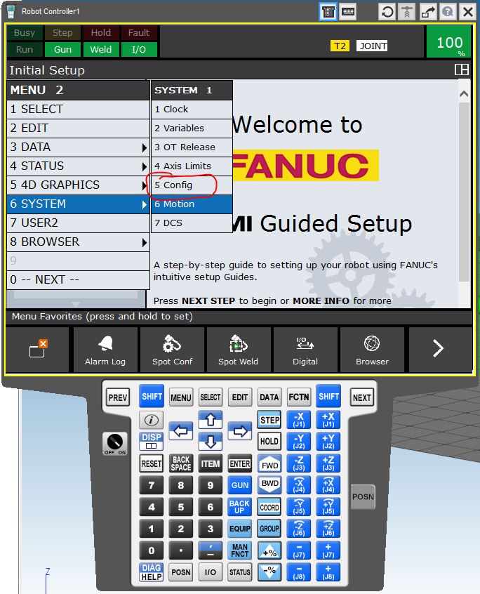

You can access production setup below method for how you want to run your robot in AUTO mode.
1>>
2>>
3>>
4>>

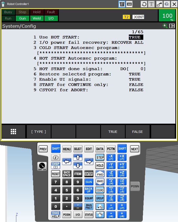

5>>
6>>
Set it to your BG logic or set it 1 for Auto Mode.
