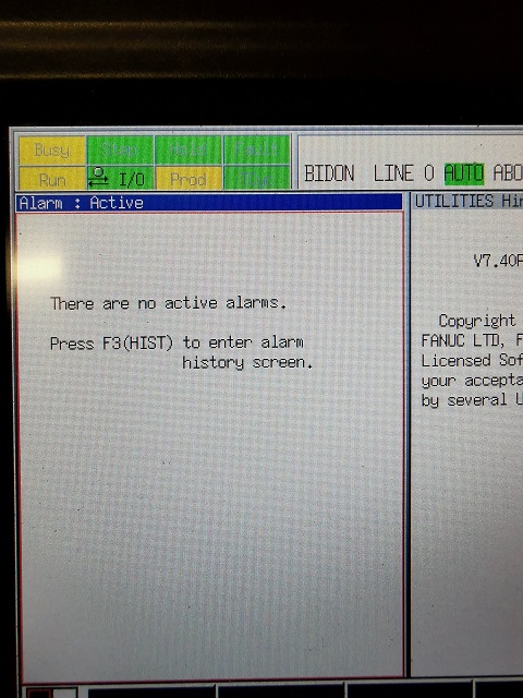

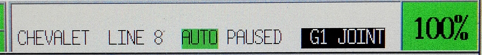

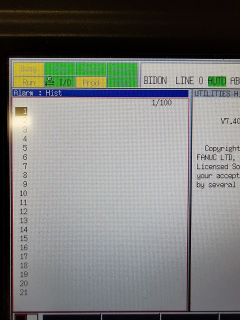

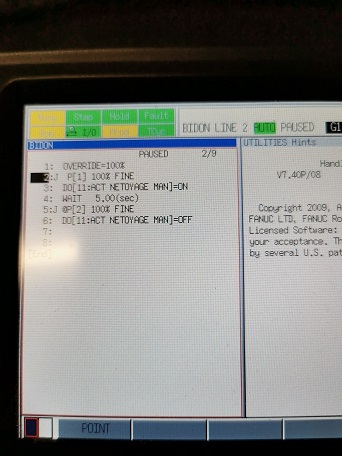

I have a M-710iC with an old R-J3IC. I'm not able to start any program in AUTO mode without having to press the cycle start twice. I didn't catch the pattern yet, but it's not only when movement occurs, it just PAUSE the program after few seconds whatever is inside the program.
If I hit the cycle start a 2nd time, everything goes well.

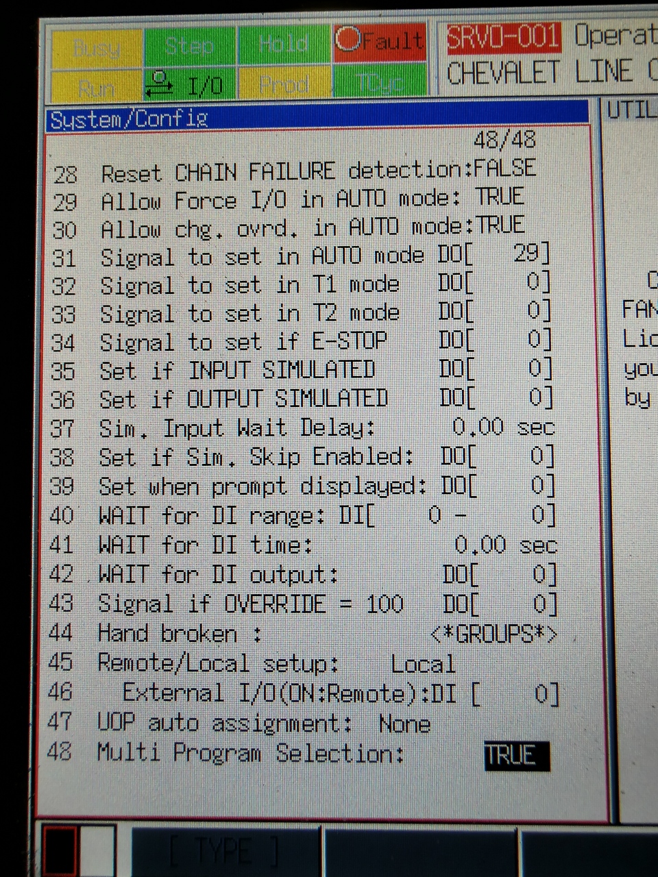

I have a Karell running in the background and unfortunately I haven't had access to the source code so I'm a bit blind. That said, I'm not getting rid of this program since it's the backbone of my ''fairly complex'' machine.
Any idea what I can check ?
I've tried the ''ignore pause'' in the DETAIL section of a program : not a success. Honestly is there any way to bypass this ?
