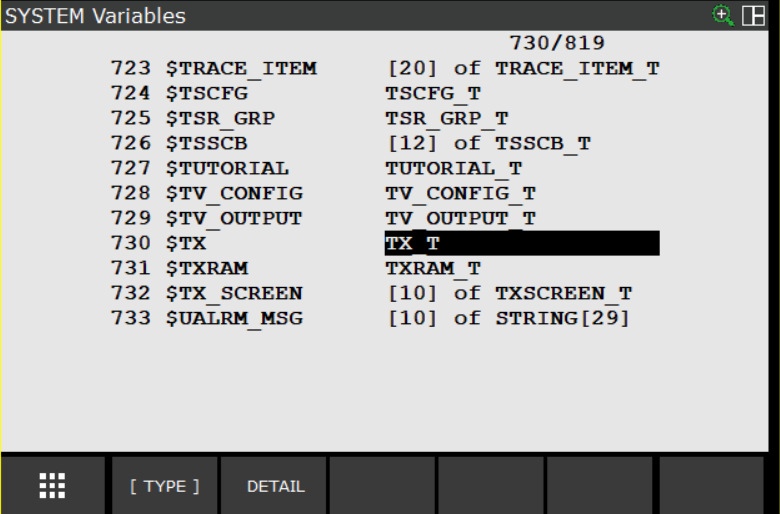

i know that to enable touch screen on the teach pendent you must change $TX.$TOUCH_ENB=(0). However i can not find this in the variables on the tp. is there another way to enable or disable the touch screen on the teach pendant?

Hi,
In MENU - SYSTEM - Variables, you will find the $TX
Press ENTER on it and you should find $TOUCH_ENB in this sub menu
Just for the understanding, the path to find the variable is the name of it ($TX.$TOUCH_ENB)
