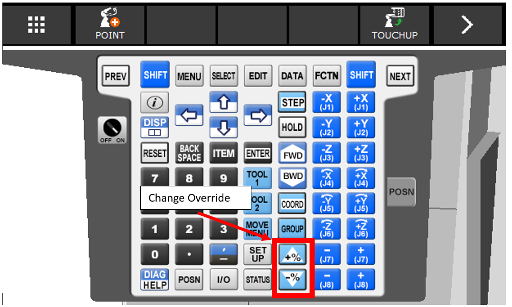

You can change it manually or in the program.
Manually:

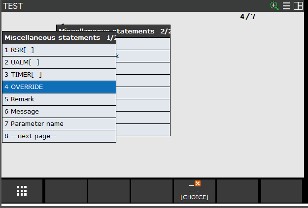

1. Presse INST[F1] and select Miscellaneous
2. Select the OVERRIDE

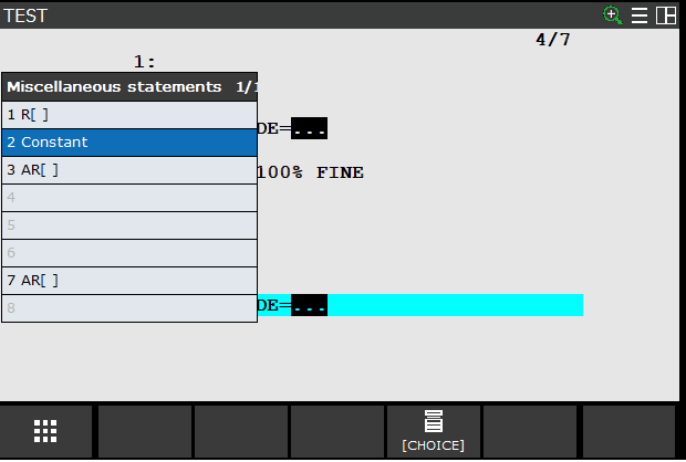

3. Select Constant

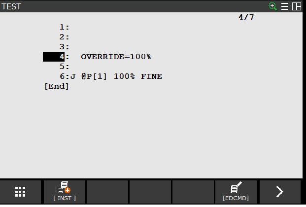

4. Enter 100 with the Keyboard and press Enter
Put this code line at the beginning of the program and the robot will run at 100% Override
