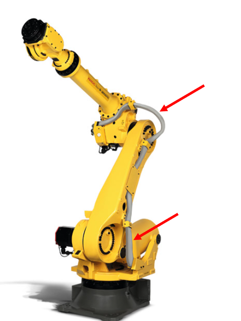

Hi all, I am working with the R2000iC. It had the SRVO-065 (BLAL Alarm) on Axis 5 continously for the past 2 months, replacing battery didnt help. Therefore we plan to replace the Axis 5's motor. But recently, I found out it had the SRVO-068 (DTERR Alarm) also on Axis 4.
So the question is should I replace both the motor of axis 4 and 5 or just the motor of axis 5 and the encoder cable of all axis.
