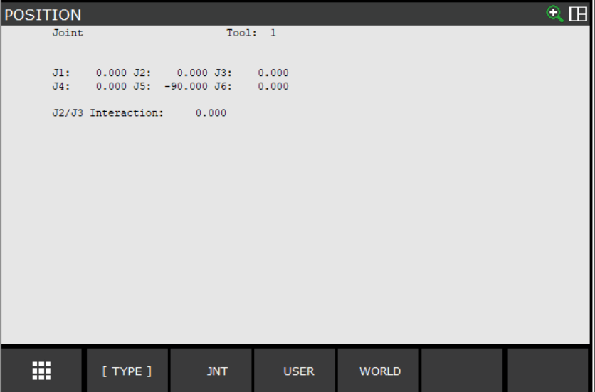

I ran into this fault the other day and it was due to the robot attempting to grab a unit that was out of position. It was found curled up and past it's soft limit. I tried disabling DCS to move it back into position and that did not work. What is the best/fastest way to recover this fault?
Hi Cory,
The MOTN-17 is for axis limit of the robot. Try pressing POSN and then F2 for JNT
You should then see what's the position of each joint
