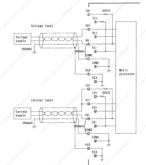

Here is how it's plugged :

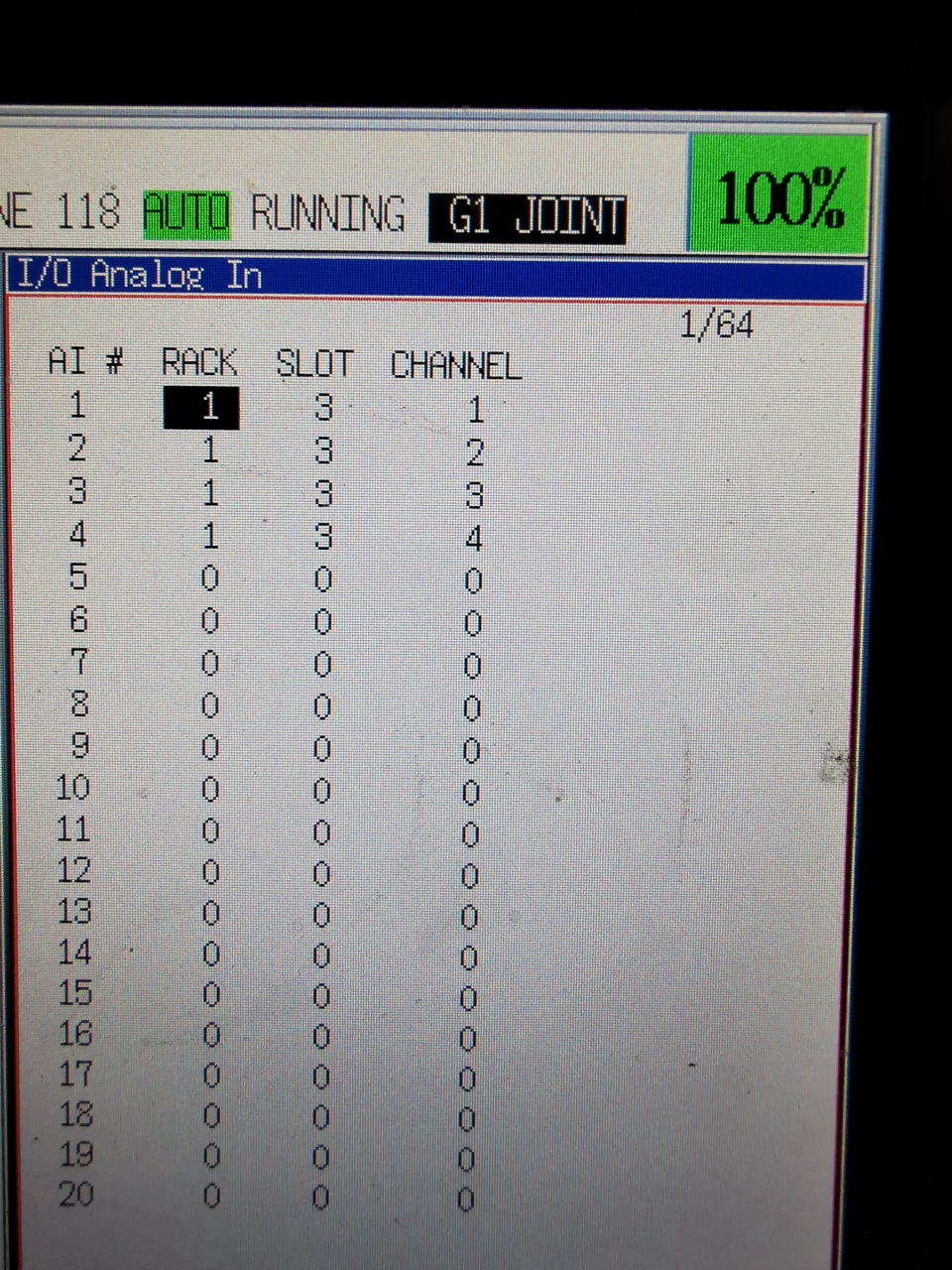

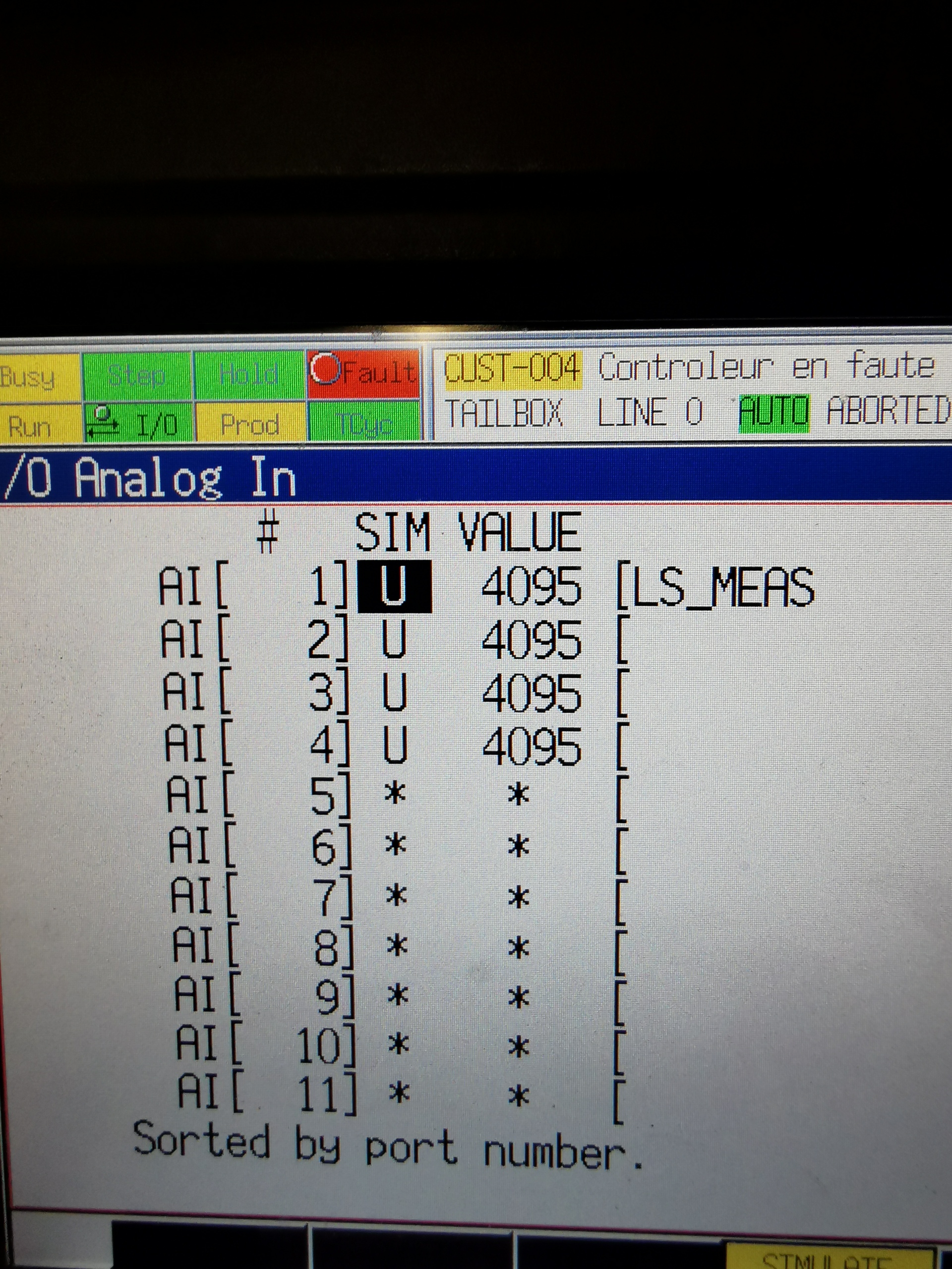

And here is the reading
Is it a ground problem ? Any wire I can bypass to check this ?
