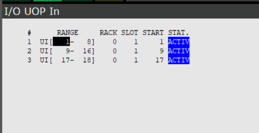

I want to start the robot with an external button linked to a UI signal. When I put the Enable UI Signals at TRUE in SYSTEM- CONFIG, the robot is not moving event in teach mode. How can I start the CRX with UI signals?

Hi John68,
Is your UI signal configured like this?
Also, check if UI[8] (Enable) is at ON.
